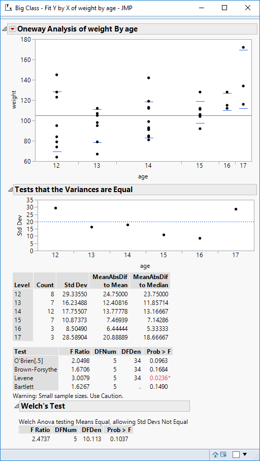

You have several ways to compare the variance in the Oneway platform. In addition to the way that Jeff showed, you can select Unequal Variances command and get this report:

Re: How can I run the test of homogeneity of variance (Levene's test)?
Reinaldo
Level IV
Thank you, Mark! Ah, I need to select Unequal Variances command to get F-ratio. Great! :)
