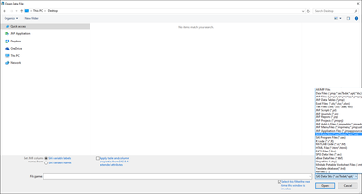

you can go to File  >> Open
there, at the bottom you can choose the file type for sas or spss or any other option in the list.
