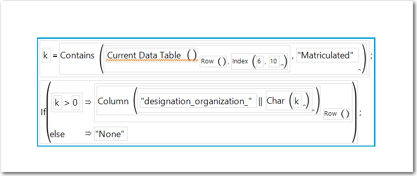

Here is the formula that works for the Matriculation data table, this is just JSL text.
k = Contains( Current Data Table()[Row(), Index( 6, 10 )], "Matriculated" );
If( k > 0,
	Column( "designation_organization_" || Char( k ) )[Row()],
	"None"

The first script you wrote for the table you attached does what I would like and is brilliant!   I'll be able to finish my project at work today.  Thanks!  However, since this is day 3 for me in JMP, I would like to understand how to write the last option you wrote using the formula editor in JMP.  When I tried to create the new column in your table after running the first script I encountered two problems:
1.) I could not use two independent functions in the column formula editor in two separate statements. I started with the Contains function and added a ";" after it.  But then when I clicked on the If function, it embedded the Contains statement automatically.  Weird.  I don't want Contains embedded within If or vice versa.
2.) I didn't see how to add the row() and Index(6,10) to the Contains( Current Data Table (),...   The ^ option gave me a new comma separated "part": Contains( Current Data Table(), part, "Matriculated").  How did you insert the rows / column options to your Contains function in the formula editor?
I have gone through the welcome kit tutorials but did not see enough info on scripting and using the formula editor in a new column.  Do you happen to know of a Youtube video you could recommend for beginners?  But I would also appreciate another reply from you if you have time.

First thing I tried was to copy and paste the blue box formula into a new column script window. It doesn't paste; it is as if the information in the blue box in your solution is a picture or screen shot.
Yes, I do know how to double click in a formula box to be able to type in a script. I still can't see how to add row and column indices to a Contain statement. But thanks again for the earlier parts to your response.
If( k > 0,
	"None"

Hi,
This script worked perfectly and thanks for helping me around my unfamiliarity with the JMP formula editor.  This elegant code was more what I had in mind when I starting trying to write my loop.  Just one last question, could you please explain your selection of the numbers 6 and 10 within the Index statement?
I'm guessing that the Index numbers 6 and 10 were because there were 5 of each of the two column types in your test file and 10 columns altogether?  So 6 starts the set of decision columns and 10 ends the decision columns?  (Decided to avoid guessing and just ask you.)

Liz_s, yes these are referring to column numbers.
From the JMP Main Menu, select  Help > Books > Scripting Guide and go page 439 (or near by). This is a section in chapter 9 Data Tables, section 1,  Working with Data Table Objects, topic Accessing Data Values . Read that entire section for alternate methods to access and assign data values.
Comment: The key to your task was to find which decision column contained "Matriculated" for each row. Looping 22+ times for each row is a lot of nesting. The key here to learn more is to use the Help > Scripting Index > Functions to learn about Contains.
Contains( list|string, matching string) returns the first position where it is found. Note: Loc() returns all positions in a list or matrix where the matching value is found. Understanding that dt[row, c1::cn] where columns c1 through cn are character will return a list of the table values.  Contains() will find the position (k), so this will be the correct position for the organization column.
The key is to "know your tools" how to access and assign and know your functions.
