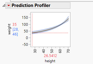

You could also look at using the Box-Cox transformation built into the Fit model platform.
Without transformation:
with transformation
