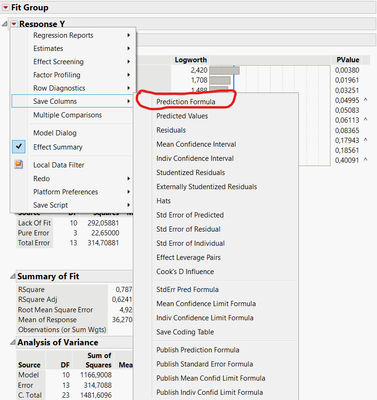

  • About Prediction Formula : To save a prediction formula to a table, go to the red triangle next to the name of the response (example "Response Y"), and click on "Save Columns" and "Prediction Formula" :

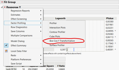

  • About predicted negative values : Finally, about your problem with negative values, maybe a response transformation could be used, for example a logit one (example from the Community here : Solved: Constraining Fit Model Output (or prediction profiler) to a Range - JMP User Community). There are other possible transformations available in the column formula that could help you (log, log x+1, exp, power, ...), or directly in the Model panel, for example a Box-Cox transformation if your assumptions for regression are not met, by going into "Factor Profiling" options, then "Box Cox Y Transformation" :

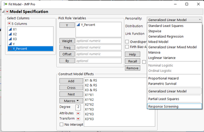

Hi, in addition to @Victor_G 's excellent reply, if the reason negative numbers are not reasonable/appropriate is because you're trying to model different distributions (percentages, for example), the Generalized Regression (JMP Pro) and Generalized Linear Model personalities can be helpful. I've attached a sample data table with scripts saved to do the analysis with both of these personalities as well as the standard least squares.

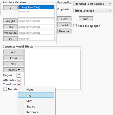

One possible solution is to change the response of the model from Y to Log(Y) ... select the transform option in the model dialog.
There are other transformations that might be more appropriate e.g. if you have percentage data.
