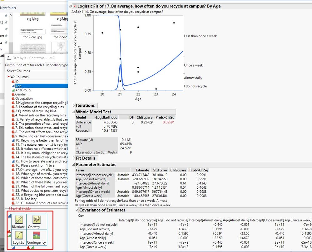

I'm trying to do relationship analysis between age and recycling frequency for a data set. After selecting and filtering some of the ages (since a lot of my respondents didn't give their age for some reason), I used the Fit X and Y tool tool and selected age for the X factor and recycling frequency for the Y factor. Then I clicked Ok and it gave me the below results.
However, JMP doesn't indicate what specific type of test it did for your data. Although it does show on the bottom left a useful table showing Bivariate, Oneway, Logistic and Contingency, it doesn't show the specific test type in the results window. But if I want to do future analysis, how can I know what specific type of test it has done, especially if its a test I haven't heard of? JMP is very different from SPSS in that you didn't really choose your test type. Any suggestions.

The outline box at the top of the displayed output indicates the analysis that has been performed:
Logistic Fit of 17 On average, how often do you recycle on campus: By Age
You can also go to the red triangle and select additional options and analyses that are appropriate for the type of data you provided to the Fit Y by X platform.  JMP does not give you a static display environment once you make your initial selections.  This is where JMP and SPSS differ.  JMP allows you to see your initial analysis, and then continue directly from that point, to do sub analyses and charting and subsetting, without having to go back to the initial dialog box and make changes, and then rerun the analsis all over again.
And finally, if you go to the red triangl, and select "Save Script", you can save the script that will rerun the analysis.  One of the places you can save the script, it do the data table you ran the analsis on.  This way, you can always have a way of going back and recreating the analysis directly from the data table, whenevery you need to.

TXNelson is correct but I want to add an (unasked for) comment.  With 9 data points and such a narrow age range, this logistic regression is almost meaningnless.  Actually, I'd say it is meaningless.  You would be better served to just make age nominal and do Fit Y by X (you'll get a contingency table and an meaningless chi-squared test).  It does make me wonder about your data.  If age is missing for many observations, you should not omit those points but code them as "missing" and use them in the analysis (with age as nominal).  If the ages of 21-24 are meaningful differences in ages, then the contingency table should suffice for seeing what the relationship looks like, if there is any.  Logistic regression, in this case, seems to me to hide the real limited nature of the data you have.
