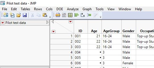

Hi there, I know this is probably very easy for most but I've been searching through the JMP discussion pages, and also google searches just to simply do the following.
I want all the data in my "Age" column to be "referenced" or the same, as another column called AgeGroups since in this column I have made age ranges for the data values (16 to 24, 25-30 etc..). I've seen plenty of similar discussion questions about scripting related problems. I've been searching but I really can't find an answer that I can understand as I just got started with JMP after previously using SPSS. I've only had a little experience with the SPSS' syntax but I'm still very new to programming. Help is much appreciated.

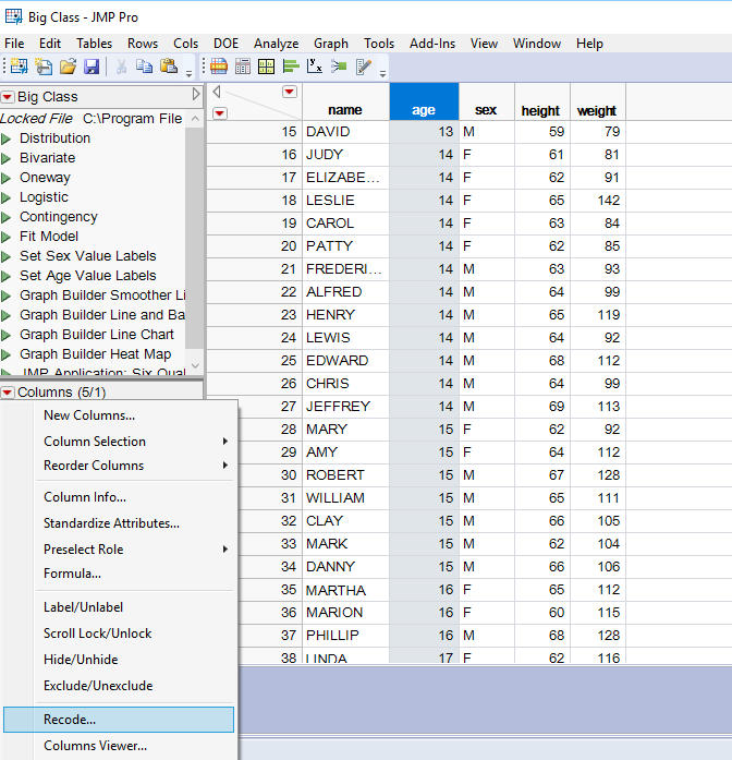

There are a few different ways you can accomplish what you want.  From running in an interactive mode, using "Recode" is probably the easiest way.
Select the column to be recoded
Then click on the red triangle in the column panel and select "Recode"

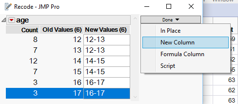

Then just fill in the new bins you want
and then click on Done, and select new column, and you will find the new binning column
You can also select to make a "Formula Column", rather than a "New Column".  If you do this, the new column that is created is done using a column formula, rather than hard coded values.
