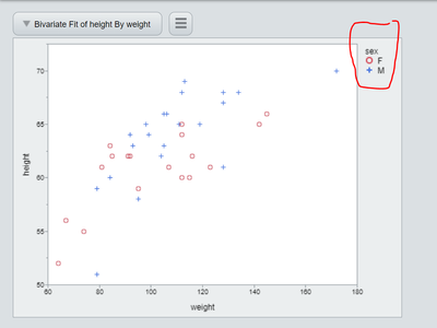

How can I highlight data points when clicking on legend in interactive HTML?
I have a bivariate chart saved as interactive HTML. I would like to be able to select a legend and highlight points on the chart. Is it possible to do this using JSL?
This is the chart after saving as interactive HTML.
Here is the JSL script:

rbiv = biv << report;
rbiv << Save Interactive HTML( "height_weight_chart.html" );

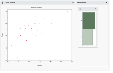

Legends aren't interactive in Interactive HTML, unfortunately. But you can achieve something close using a dashboard:

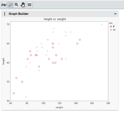

Thanks for your question, @simon_2. In JMP 17, HTML5 supports interactive legends in Graph Builder reports.
