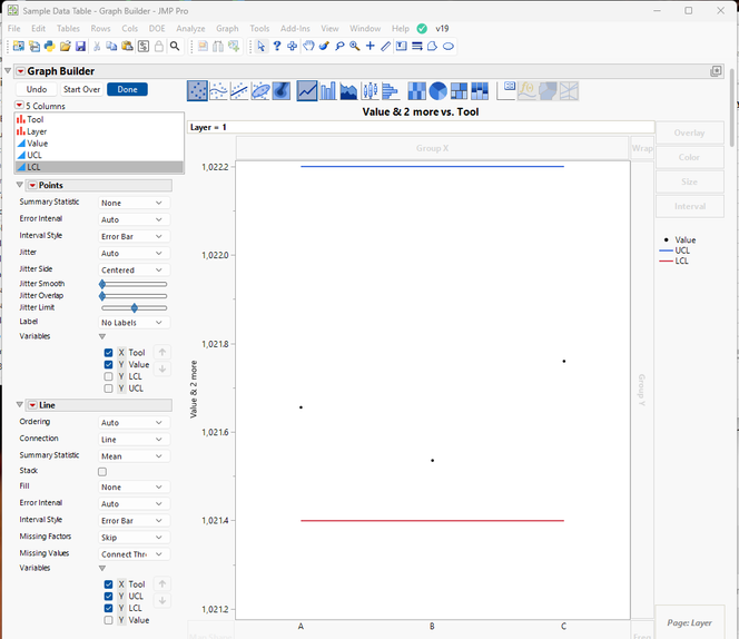

How can I get my graphing script to reference my row-wise control limits and add them automatically to my graph? WIP script included
Hi there! I am working on creating a script that graphs a numerical value (X) against Tools (Y) that includes given upper and lower control limits in the data table that vary by subgroup, and will automatically include the limits on the graphs when the script is run. I also need these graphs to be separated by "Layer". Here is what I have so far. I can get the graphs to generate, but I can't seem to get the control limit lines to show up. Also, the first graph has much smaller point sizes than the rest of the graphs. I'm still relatively new to writing scripts from scratch, so any help is much appreciated! Here is what I have so far. (JMP version: 17.2)

Re: How can I get my graphing script to reference my row-wise control limits and add them automatically to my graph? WIP script included
You just need to add the UCL and LCL to the Y axis and then add a line, specifying that Value is the only variable to be used for the points and that LCL and UCL are the only variables to be used for the lines

Hi Jim, thank you for your reply! I was able to get the graphs to generate, but the biggest issue I'm running into now is that I still can't figure out how to add in the UCL and LCL reference lines into my script so that when it's run, the graphs are separated by layer and each graph has its respective LCL and UCL reference lines included on it. The UCL and LCL are columns in my data table, just can't seem to figure out the correct way to reference them.

cmarsh26
Level II
Got it, this worked! Thank you!
