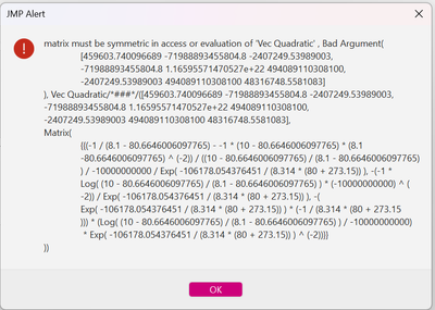

  • I also tried using “Custom Inverse Prediction”, but I received an alert message. I guess that's means something is wrong with my model setup, so I should'nt trust my work :')

The issues you describe are typical for many Nonlinear least-squares regression algorithms. Unlike linear regression, nonlinear regression fundamentally requires a "good guess" for the starting parameters, and there is no guarantee it will converge every time. JMP's approach to this is to use visualizations and "sliders" to allow you to easily set up the parameters before running the fit. You can also "lock" a parameter or set allowed ranges.
Since you are doing a study of the "aging" of your product, that is, the change over time of its properties, I recommend using one of JMP's Degradation analysis platforms. Note that there are two platforms: "Repeated Measures Degradation" and "Degradation". If you will be doing this analysis often, I recommend reading those links to learn more about the advantages of each platform. Personally, I recommend starting with Degradation, especially since you are already familiar with the Nonlinear platform.
