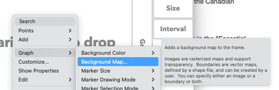

the background map is super easy. Do a right click on the graph space in graph builder, select Graph>Background Map

Thanks very much for the rapid response and I'm sorry for taking this long to get back to you. The issue is, when I do exactly what you say above, the map does not appear. I've tried to trouble shoot and as such I have played around with the Maps file in JMP with the Canada maps there. In short, I can get the background map to appear in the pre-installed Map Files (CA-Admin1-Name.jmp) but even here when I try to include the Census Consolidated Subdivisions boundary file I have downloaded (using the check box for this file from the Boundaries list on the right hand side of the "Background Map" panel) JMP immediately crashes, every time. So in one case I can't get the background map although I can get the boundaries (and I've followed your instructions exactly and tried every option from "Simple Earth" down and still I do not get a background map) and in the other I can get the background map but not the boundaries, hah!
