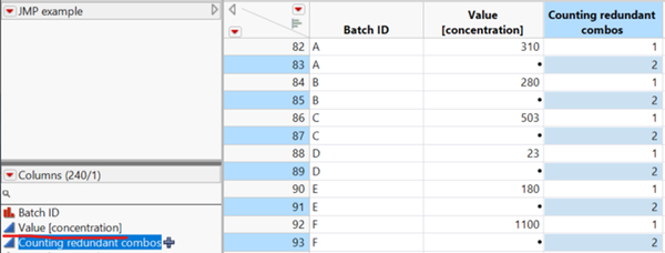

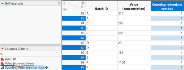

Here I am counting redundant rows based on info held in 2 columns (Batch ID & Value [concentration]).
Col Cumulative Sum( 1, :Batch ID, :"Value [concentration]"n )
However, based on whether Value [concentration] is formatted as continuous or character variable in my table, a different result is obtained (see screenshots below).
Outcome with Value [concentration] as continuous variable (not what I want)
Outcome with Value [concentration] as character variable (what I want)

Some with more knowledge will have to provide correct answer why this is happening with numeric columns (your second example has Character column, not just Nominal numeric column), but you might be able to handle it depending on what you are doing by using something like:
Col Cumulative Sum( 1, :Batch ID, Col Stored Value(:"Value [concentration]"n ))
or
Col Cumulative Sum( 1, :Batch ID, IsMissing(:"Value [concentration]"n ))
-Jarmo

Yes, sorry for using incorrect terminology. I have revised that now in the original post.
I changed the concentration data temporarily to character format, since I know (from experience) that this is working.
Thank you for your reply!
Ressel
Level VII
Re: Counting redundant rows using by variables - different outcome for continuous and nominal by variables?
Thank you for the example by the way. (Downloaded & saved.) I still find it illogical and weird that the numerical column as by variable doesn't recognize the missing value.
