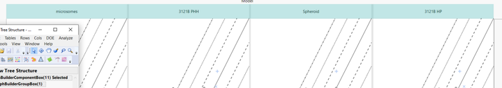

Re: How can I change font of graphbuilder group box title in graph builder
Hi,
Still I have one problem is not solved- changing font in graphbuilder group box title (i.e. microsomes) (see below green highlight upper part). I tried to increase font size, then soooo difficult to find. I've tried to find also in JMP library document/help/tutorials, but no success. Is this only way to change the font using script?
One of the font selections in
File==>Preferences==>Fonts
is used for the Grouping text sizing.
Hi,
Thanks- Jim,
Althought I tried, it didn't work...-not change the group title font (not working... ).
As stated in my last response
"One of the font selections in
is used for the Grouping text sizing. "
It turns out that the Font that it is using is the "Text" font
@txnelson (Jim),
THANK YOU! You are absolutely right, I've even thought 'TEXT' would be the title (of group). It would be great that it can be changed same way for legend.
