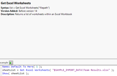

mmarchandFSLR
Level VI
Re: How Can I get a list of sheets in an Excel workbook ?
Seriously?  How did I not know about this.  Thanks, though, very helpful!
