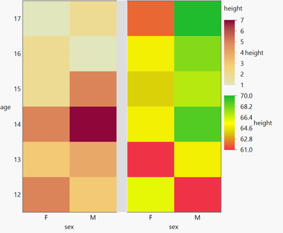

Re: Create duplicate heat-maps with different summary statistics in Graph Builder
@BHarris wrote:
I tried adding another Color() specification but it doesn't seem to work in JMP 17.
-> add another color
Works with JMP 17 (.2)

BHarris
Level VII
Excellent, that worked!  I think I was missing the extra X variable when I added the color spec.  It would be nice if GB supported this with the UI, but it already does so much...

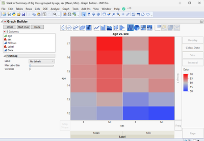

txnelson
What I did was to
  1. Use Tables=>Summary to create a new table with the mean and min statistics grouped by Sex and Age
  2. Use Tables=>Stack to stack the mean and min columns
  3. Run Graph Builder
names default to here(1);
dt =
// Open Data Table: Big Class.jmp
// → Data Table( "Big Class" )
Open( "$SAMPLE_DATA/Big Class.jmp" );
// Data table summary
// → Data Table( "Summary of Big Class grouped by age, sex" )
Data Table( "Big Class" ) << Summary(
	Group( :age, :sex ),
	Mean( :height ),
	Min( :height ),
	Freq( "None" ),
	Weight( "None" ),
	statistics column name format( "stat" ),
	output table name( "Summary of Big Class grouped by age, sex" )
// Stack data table
// → Data Table( "Stack of Summary of Big Class grouped by age, sex (Mean, Min)" )
Data Table( "Summary of Big Class grouped by age, sex" ) <<
Stack(
	columns( :Mean, :Min ),
	Output Table( "Stack of Summary of Big Class grouped by age, sex (Mean, Min)" )
Graph Builder(
	X Group Edge( "Bottom" ),
	Variables( X( :sex ), Y( :age ), Group X( :Label ), Color( :Data ) ),
	Elements( Heatmap( X, Y, Legend( 4 ) ) )
