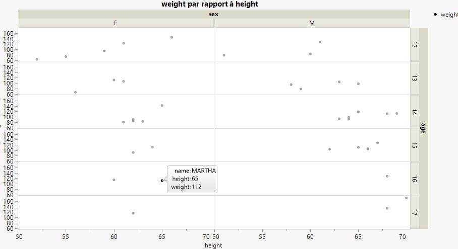

I don'nt understand your script:
see the image, there is no image in the label.

@nascif_jmp, I have validated @Françoise finding that no graph is displayed in the graphlet running JMP 15.  However, the graph does display in JMP 16.

@txnelson thanks for checking.
You are correct, the thumbnail argument which is the main issue @Françoise was asking about is a JMP16 only feature. This has been established early on in this thread, in my exchange with @Emma1. I assumed she was aware of it but I should have been more explicit (perhaps added a version check to the script).
It would be possible to make a JMP15 equivalent version by scaling the image down explicitly, before returning it to be displayed in the Picture script (graphlet JSL callback).
