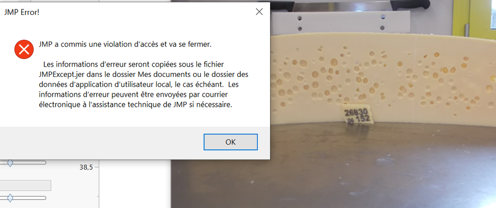

I tested my script under JMP 15, I did it several times, and each time this error message appears (and JMP 15 closes) :
Do you have an explanation ?
I had a message, which has already gone to technical support

I tested the same script on JMP 15 on another computer and got the same error message, which is displayed as when clicking on the photo in the thumbnail

Good to see you making progress. Regarding the error message, my guess is that it was related to the use of the Thumbnail attribute which is not supported in JMP 15. It seems that you don't get an error message in JMP 15 once it was removed, is that correct? Also, in your code example, you commented out the Thumbnail() attribute but left the preceding comma. I would remove it too.
