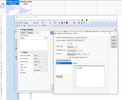

In my data table, I have thousands of cryptic column names.
Is there a possibility to facilitate work with the table (human readable names)  - but keep the data table compatible with the incoming data (keep cryptic names).
e.g.
- alternative column name in the preferences
- replace column names with name from notes
- extend "search for notes"?

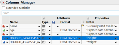

Column Manager in Jmp18 already helps a bit:
Names Default to Here(1);
Data Table( "Big Class" ):height << Set Name( "FDGDGD_645643545343_h" )<< Set Property( "Notes", "height" );
Data Table( "Big Class" ):weight << Set Name( "DFGDGD_435435343_w" )<< Set Property( "Notes", "weight" );

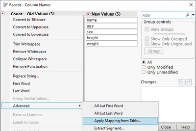

You could create mapping table and use that to go back and forth with Recode
