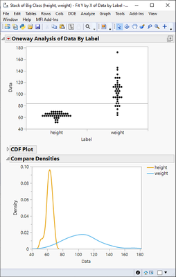

jthi
Re: Histogram Distribution to Fitted Line Only
Are you trying to compare densities to each other or something else? You can do that for example by using Fit Y By X (you might have to stack your data first)

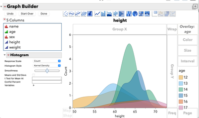

Byron_JMP
Staff
Graph Builder does a pretty nice job with data like this
All the measurements need to be in one column and the categories need to be in another (stacked format)
Histogram Style dropdown is set to kernel density
That works! Can I scale the counts some how? I scaled 10ekV and 15ekV relative to 5ekV by doubling and tripling the data, respectively, but I'm wanting to add another data set for 2.5ekV that would require me to divide counts so my method wont work.
