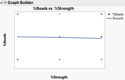

Hello JMP community,
I am preparing my talk on the upcoming discovery summit.
Because of confidentiality reasons I cannot show the y and x-axis labels.
See pic, where I removed the axis box via the properties visibility option.
Normalizing all the data to range 0 to 1 changes all the analyses I did with scripts.
So as I see it, I need to keep the original (confidential) numbers but need to hide the Axis Box.
Can anybody assist me with a better idea than doing it manually in the properties or something totally different approach how to avoid showing confidential data?
Ideally there would be something like a column properties which suppresses the number showing on the axises in all analyses.
Appreciate a hint for an easier way to do this!
Thanks!
Ben

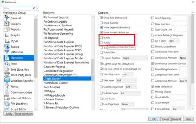

I was expecting to have this ability in the preferences but i didn't manage to see any difference with or without these options selected. Can anyone demonstrate the difference?
Benjamin_Fuerst
Level III
Re: Hide x-axis and y-axis number label
@ron_horne I could not see a difference having it ticked or not in the graphbuilder...
Hi @ron_horne ,
have you restarted JMP after changing the preference?
ron_horne
Super User (Alumni)
Hi @Florian_Vogt
i did restart, could you show me a picture of with and without these boxes checked?
so i know what to look for.
Hi @ron_horne ,
I was initially rather generally speaking - while I wanted to prepare the screenshots, I found out this is a bug which is already under construction and will be solved.
The correct way is, the boxes (that you have outlined by a box in your screenshot) are ticked as default. If you uncheck them and restart JMP, the graph builder will not show the axes.
Best
