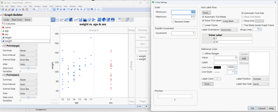

Hi @hogi ,
if it is the first or last category you may be able to exclude it by changing the axis settings as such.
this can also be done manually with the grabber tool.
let us know if it works.

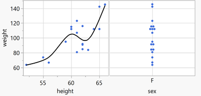

to my knowledge only by adding a local data filter:
Best
Florian
hogi
Level XIII
Re: Hide Level from a plot
Hm, the Data Filter will remove the corresponding rows from everywhere in the plot -  not just remove the label from one axis.
Names Default to Here(1);
Graph Builder(
	Variables( X( :height ), X( :sex ), Y( :weight ), Color( :sex ) ),
	Elements(
		Position( 1, 1 ),
		Points( X, Y, Legend( 24 ) ),
		Smoother( X, Y, Legend( 25 ) )
	Elements( Position( 2, 1 ), Points( X, Y, Legend( 26 ) ) ),
	Local Data Filter( Add Filter( columns( :sex ), Where( :sex == "F" ) ) )

Hi @hogi ,

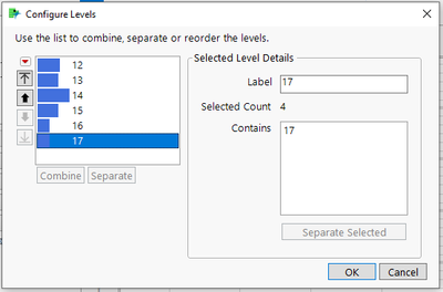

Hi @ron_horne . This is a nice workaround which will work for simple plots like here for Big Class.
Good, that I can make the level  "last" by adjusting the Levels settings :)
But the workaround is kind of fragile - the position will depend on the # of of labels in the current data set.
And it gets very difficult to count if multiple columns are used in a hierarchy on the Axis.
