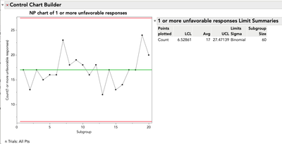

I'd use a p-chart

May be homework, but the UI for setting up attribute charts in Control Chart Builder is only intuitive for people who are already well-versed in using the platform.
I think all JMPers should look out for each other so I don't mind helping out new users with homework assignments. : )
