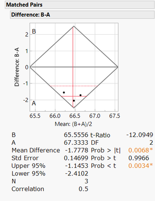

The data collection looks like the table Statistical analysis data collection (see attachment). My idea was to take an average for each sample, and then perform a matched-pairs analysis (see attached Statistical analysis matched-pairs). In example, I can see that the two equipments measure diffently.

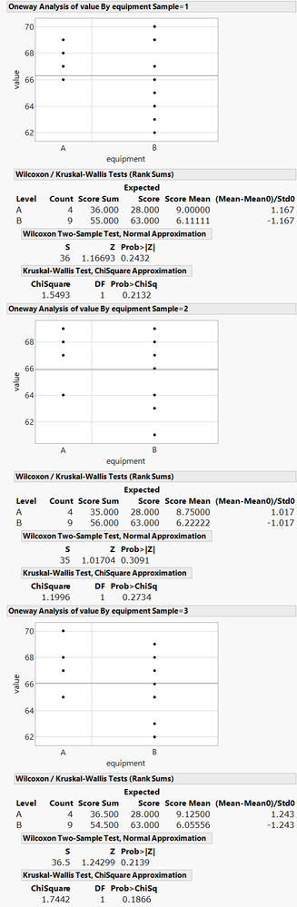

However, if I compare the data in the table Statistical analysis data collection  with Fit Y-by-X and run a non-parametric test for each sample, I can see that the differences are not statistical significant for all the samples.

And you may want to ask yourself if the difference (statistically significant or not) is meaningful. i.e., the confidence interval may be very tight, and it may not include zero (indicating statistical significant different)...but is that confidence interval a practically meaningful difference? For example, in your matched pairs analysis, the conf int on the difference is -2.41 to -1.15; that is a very small difference.  From a practical/scientific point of view, is that difference (somewhere between -2.41 and -1.15) relevant?

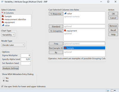

Not a statistician, but this looks like an application for variability analysis (Analyze > Quality and Process > Variability / Attribute Gauge Chart) or MSA (Analyze > Quality and Process > Measurement Systems Analysis)

I have tried the Variability/Attribute Gauge Chart, and the result is similar to the matched-pairs.
My concern is that, in this way, I am working with averages, but the limited number of samples and the large spread lead to a large uncertainty in the average estimation.
Is it still fine to work with averages?

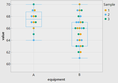

@bbenny7 I need to repeat my warning that I'm not a statistician, but looking at your more detailed table Statistical analysis data collection.jmp, I am uncertain what the denomination "Sample" means. Are you expecting actual differences between them, and if so do you expect these differences to be due to 1, 2 and 3 having different properties or are these differences perhaps a result of sampling variation?
Looking at the plot below, as a first approximation, would it be enough to assume samples 1, 2 and 3 are identical (or prove it with via ANOVA) and then compare the group means for equipment A and B against each other?
Also, your comment "the large spread lead to a large uncertainty in the average estimation" is already a conclusion that sounds potentially useful for communication to whoever may be interested in the results.

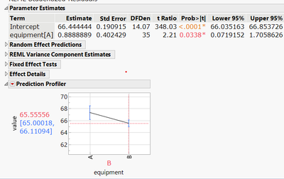

I have one more question about the parameter estimates: I cannot see equipment [B] and the intercept doesn't match the value for equipment [B]. How should I calculate the value for equipment [B]?
MRB3855
Re: Help with statistical analysis of repeated measurements
Hi @bbenny7 : It's the way the model is parameterized
-Edit: Details here if interested: https://www.jmp.com/support/help/en/18.0/index.shtml#page/jmp/nominal-factors.shtml#
Intercept is interpreted as the average across both pieces of equipment.
A =  intercept + 0.8888889
B =  intercept - 0.8888889.
You can see this and comparisons etc if you open the "Effect Details" output.
