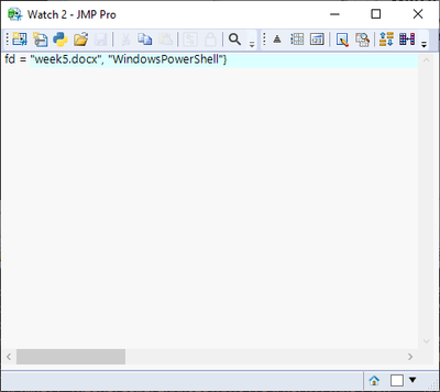

With JMP 17, the Files in Directory script command appears not to work if there are leading numbers, or numbers in the file name.  The Watch window returns various errors unless all file names are number free.
<jsl> folderPath = "C:\Users\first.last\documents";
<jsl> fd = Files In Directory( folderPath,1,1 );
<jsl> w = Watch ( fd );
Is this fixed in a different release?  Suggestions?

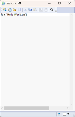

It looks to be an issue with the way the Watch window displays the variables.  The variable "fs" is properly defined.  No issues appeared until I added the "05 Messages.xls" file.  I would just avoid the Watch() function.  Show() works in any situation, as far as I can tell.
Names Default to Here( 1 );
dir = "$DOCUMENTS\JMP Scripts\zero test\";
fs = Files in Directory( dir, 1, 1 );
w = Watch( fs );
Show( fs );
//fs = {"0 is smaller than 1", "00five-oh.txt", "0meansinfinity.txt", "Hello World.txt"};
w = Watch( fs );
Show( fs );

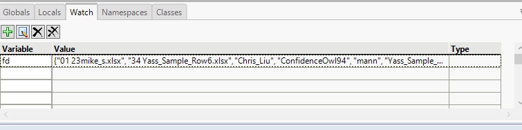

Re: Files In Directory
I changed my file names where one file starts with "01 23mike_s.xlsx".
Running in JMP 17.2 I have no issue in my watch window
Jim

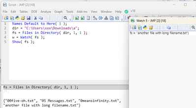

Besides watch in the GUI of the debugger, there is a watch() command:
I just checked some files with 0s with JMP v18.2.1:
seems that it's not the 0s, but a line break which causes the issue - after adding another file:
