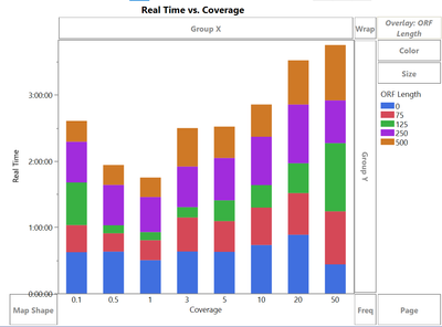

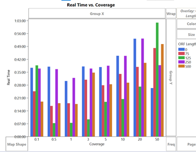

Does anyone have any advice for modifying graph builders default scripts? I'm trying to build a stacked bar graph of some data but my issue is that jmps "stacked" option sums all of my data together (stacking it all), when I would rather it not sum the data and essentially overlay the different layers into one bar. Here are some pictures to help.
So my starting point is this bar graph, with my different classes represented side-by-side.

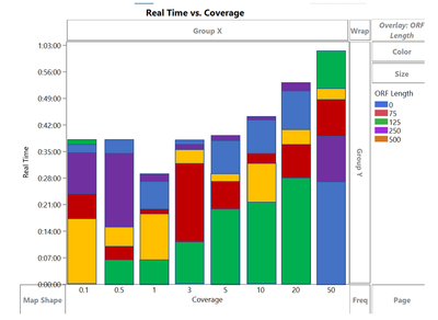

As you can see here my highest value is roughly 1:00:00. I would like to condense each of the coverage categories into one bar, but the default options are not pretty. If I stack them (see below) it sums them all and my highest value becomes 4:00:00 which is not desirable.

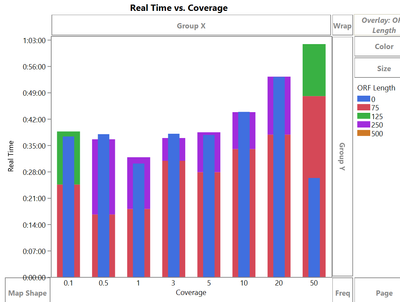

 The closest option is nested (below), but frankly this looks absolutely terrible and hurts my eyes. nested.PNG
 Is there a way to modify this nested format so all the bars have the same width, and the shortest ORF Length bar is placed as the top layer, so that all ORF Length bars are visible in a single bar.
Bullet style (below) is also a similar option. But the problem here is; again not all bars are equal widths, and more importlantly it doesn't reorder how the ORF Length bars are ordered, so many of the shorter bars (ie 500) are hidden behind larger bars.bullet.PNG
