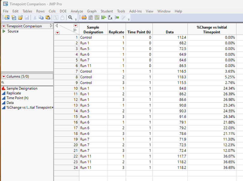

I will be collecting data at specific timepoints for multiple different samples.  Each sample has a corresponding value for the initial (T=0) timepoint and I would like to have a column for the %difference at a given timepoint relative to T=0.  The table will include multiple replicates of each sample (arranged in rows) and a dozen or so metrics (in columns).  Here's the general idea of the table format:

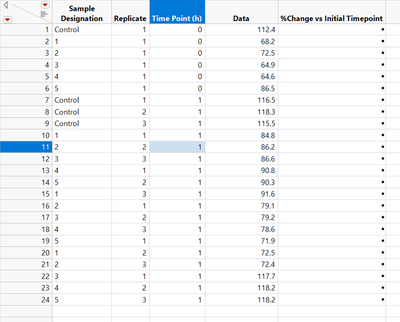

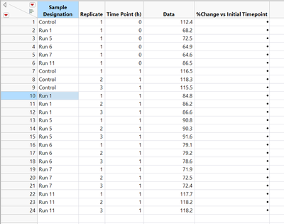

The image in the thread doesn't accurately represent the replicate measurements...sorry.  The jmp table is correct.
This image is correct also:

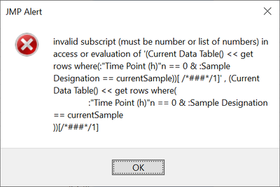

Thanks for the response.  I've tried the above and get the following error message:
Note: I had pasted in your script to a "New Script" and run it.  I also tried using the script in the formula editor...in that case there was an error stating that the Current Data Table function has side effects or is inappropriate to use in a formula.
