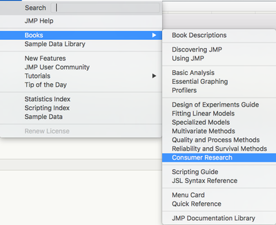

to run the script:
View->Log (just in case there are messages)
File->New->Script (ctrl-t)
copy and paste from above
Edit->Run Script (ctrl-r)
You can read through the script and find some variables to tweak (noise, people, kinds) and re-run it.  Probably best if you close the data table and cluster from the previous run before running it again, but not required.
There is a scripting guide (PDF) under Help->Books->Scripting Guide that will help too.

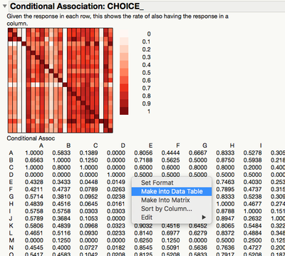

Another option (thanks to melinda.thielbar for the tip) would be to use the categorical platform using the conditional associations option.  This will compute the conditional probability of one response given a different response.  Here is another conditional association post in the community with the details of how to access from within the categorical platform.  Additional details can also be found on page 48 of the Consumer Research book (Help-->Books-->Consumer Research Or using the Consumer Research online documentation.)
10721_Screen Shot 2016-01-05 at 2.30.28 PM.png10721_Screen Shot 2016-01-05 at 2.30.28 PM.png
I have attached two data tables with the analyses.
The first table is just your Excel file imported as a JMP data table with the categorical analysis using the conditional association option.
The second table is the conditional association output.  I generated this table by right-clicking on the table produced from the conditional association report and selecting "Make Into Data Table."

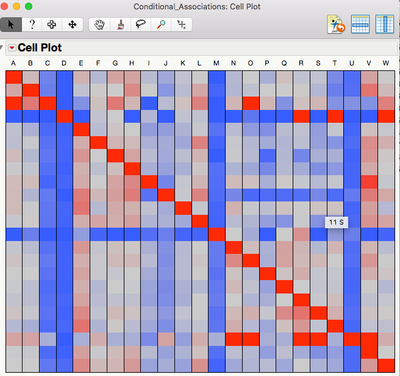

10717_Screen Shot 2016-01-05 at 2.27.26 PM.png10717_Screen Shot 2016-01-05 at 2.27.26 PM.png
I then recreated the cell plot using the cell plot graphing platform.  You can rerun from the table script by right-clicking on the table script and choose run script to relaunch the analysis.
