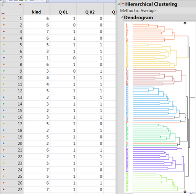

Here's some JSL to generate a table with a script to try out the clustering idea.  The prime number stuff is just a way to make the different types of people have different sets of answers.
// synthesize some data with 86 rows of 24 questions where there are kinds=7
// types of people answering the questions.
// the RunMe script in the table will re-randomize and add colors by Kind and
// run the Cluster platform.  The random "noise" means the clusters are not
// perfect; the colors in a cluster are from "kind" but the noise might
// make kind be too far from ideal.
// notice: the cluster platform does not use "kind" but still groups them pretty well.

the script is mostly just making a table of data similar to what I think you described.  As Robot suggested, you can run the platform against your data without a script.
to run the script:
View->Log (just in case there are messages)
File->New->Script (ctrl-t)
copy and paste from above
Edit->Run Script (ctrl-r)
You can read through the script and find some variables to tweak (noise, people, kinds) and re-run it.  Probably best if you close the data table and cluster from the previous run before running it again, but not required.
There is a scripting guide (PDF) under Help->Books->Scripting Guide that will help too.
