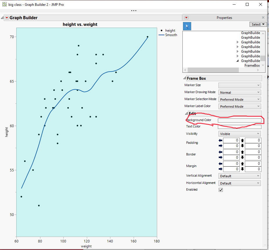

You should be able to go to
     Edit=>Properties
and then click on the area of interest and change the background color
But for JMP 15, changing the background color of the Frame Box() using this method, does not work.  It appears to have been fixed in JMP 16.

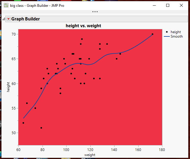

However, through scripting, you can use the
    << background color( ??? )
to get the results you want
Names Default To Here( 1 );
dt = Open( "$SAMPLE_DATA/big class.jmp" );
gb = Graph Builder(
	Size( 528, 456 ),
	Show Control Panel( 0 ),
	Variables( X( :weight ), Y( :height ) ),
	Elements(
		Points( X, Y, Legend( 3 ) ),
		Smoother( X, Y, Legend( 4 ) )
Report( gb )[FrameBox( 1 )] << background color( red );
and change the color
Jim

In my JMP 15.1.0 (win10) in GB I can Change Background Color via context menu interactively.
