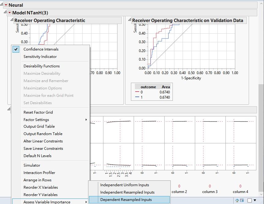

Thank you for replying. I did prediction model of neural network, I selected Profilers>Assess Variable Importance>Dependent Resampled Inputs, and will show a list of variable importance. According to the JMP Help, the importance was calculated using a k-nearest neighbors approach. My question is that if I can know the k value of this k-nearest neighbors approach?
