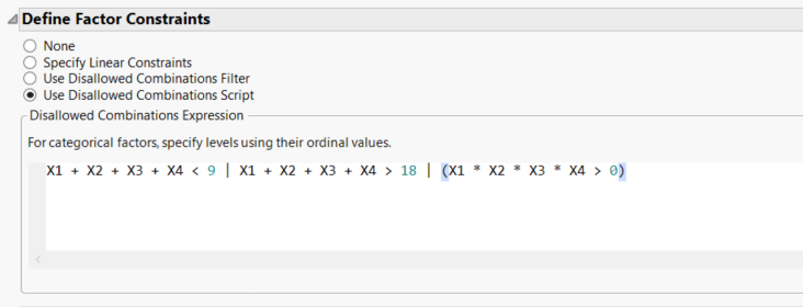

As such, I have specified the above-mentioned constraints under the "Use Disallowed Combinations Script", as follows:
X1 + X2 + X3 + X4 < 9 corresponds to the 1st constraint: total ingredient concentration in each recipe cannot be lower than 9.
X1 + X2 + X3 + X4 > 18 corresponds to the 2nd constraint: total ingredient concentration in each recipe cannot be higher than 18.
(X1 * X2 * X3 * X4 > 0) corresponds to the 3rd constraint: There are can only be a maximum of 3 ingredients in each recipe.

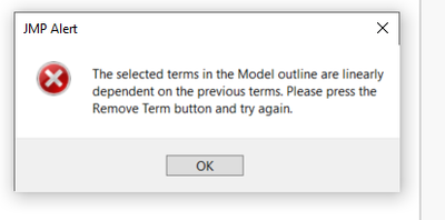

However, I run into an error when generating the design, as shown below:
After some troubleshooting, I am able to successfully generate the design with only the first two constraints (X1 + X2 + X3 + X4 < 9 | X1 + X2 + X3 + X4 > 18). I cannot seem to incorporate the 3rd constraint of having not more than 3 ingredients in any recipe. Am I specifying the 3rd constraint incorrectly? Please help. I do not know how to solve this problem.

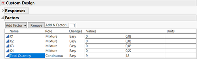

I also thought about using Mixture design, but since the total quantity of X1+X2+X3+X4 is not fixed (it should be between 9 and 18 units), I switched to an Optimal factorial design.
The Mixture design can be a good alternative for this use case by adding a 5th continuous factor for the total quantity of component that can vary between 9 and 18 :

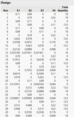

Specifying a Scheffé Cubic model and adding a quadratic effect for X5 (Total Quantity) enables to have an interesting design respecting all the constraints :
(Value of X4 for row25 could be switched to 0 without big changes, to avoid using 4 components in the mixture if really needed).

I run into the error even when only specifying the 3rd constraint: (X1 * X2 * X3 * X4 > 0). Is there anything wrong with this expression?

May I ask the reason behind your third constraint ? If there is a practical reason (solubility for example), you can keep it, but else, I would not restrict the experimental space beforehand, but more likely do it afterwards. This helps increasing the inference space, finding optimums, and make sure you didn't explore a promising area, as well as making sure that your third constraint is feasible (perhaps you won't reach an optimum if you don't have the 4 components).

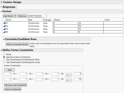

It seems there are some errors in defining your design :
  1. You can use "Specify Linear Constraints" for your first and second constraints, it will be a lot easier to set up :
  2. Your third constraint doesn't correspond to what you intend to do and create a dependance between your factors (hence the error message). If you want to have experiments with up to 3 components maximum, specify a more simple model with up to third order terms (not higher). This way, the design generation will mostly create runs with 1 to 3 components for each experiment (only 5 out of 28 experiments in my generated design have 4 components).
  3. Finally, if you are interested in prediction over your experimental space, you can set up the optimality criterion to "I optimal" by clicking on red triangle next to Custom Design, "Optimality Criterion", and "Make I-Optimal Design". More infos on optimality criteria here : Optimality Criteria
Then select the number of runs you want, and with this setup you should have your first 2 constraints respected in the design, without error message and most of the runs with 2 to 3 components :
Here is the script to generate the design (and table attached) :

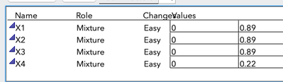

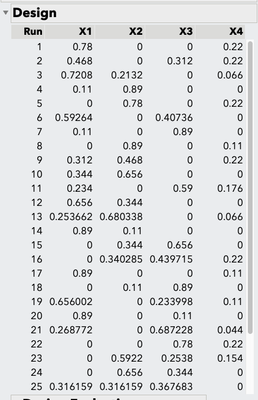

it kind of sounds like you want a mixture design like this
16/18=.89
In the model, select all 4 terms, and click Scheffe Cubic
You'll get a 30 run design like this
Once you've analyzed the experiment, you can model all the different combinations
