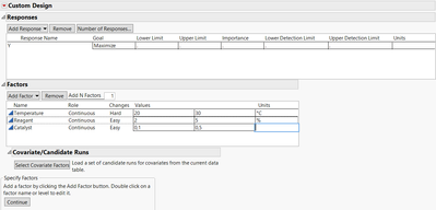

  1. Define your factors, and click on "Changes" next to each factor to change its randomization (depending if it's applied on batch (hard) or individual (easy) level) :
    Note that you can have several Hard to change factors. If you have several ones, you have the possibility to make them vary independantly from whole plot to whole plot, or not.

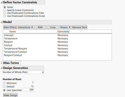

  2. Then, you can add any constraints, and specify the assumed model you want to fit, as well as determining the number of whole plots (= number of batch in your example), as well as the total number of runs. In this example, since your samples are run in batch of 96, I defined 4 batches (whole plots) of 96 samples, so I defined 384 as my total number of runs :

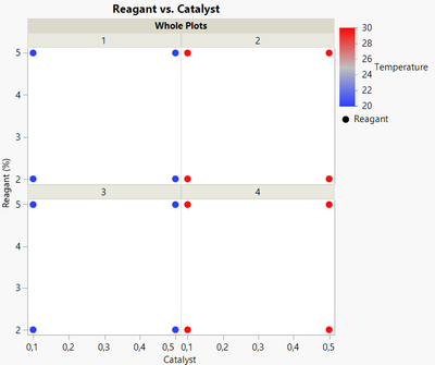

  3. Click "Make Design" to create your design. You can check that your design enable to have only one value for the hard to change factor for each whole plot :

How do I generate the graph you showed to check if there is only one hard to change value per plot? Thanks for your response!
Victor_G
Re: Help for Some Sort of Nested Design
Hi @PowerJackal4255,
There might be several ways to show the structure of your Split-Plot design.
In the specific example shown in my previous response, I used Graph Builder and :
  • Place one of the "Easy to change" factor (here Catalyst) as X variable
  • Place the other "Easy to change" factor (here Reagant (%)) as Y variable
  • Place "Whole Plots" in the "Wrap" zone (to display the repartition of factors for each plate)
  • Place the "Hard to change" factor (here Temperature) in the "Color" zone.
This enable to show that Temperature can't be changed inside a whole plot (due to the restriction randomization of this "hard to change" factor), but it can be changed between whole plots. I'm sure there are other clever ways to display this Split-plot design structure.
