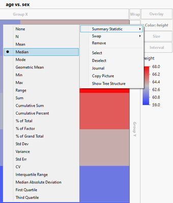

I wondered if anyone can point me in the right direction. I have a script that creates a table with Row, Column and Data fields (multiple Data field values for each (Row,Column) pair). I'd like to be able to create a Heat Map showing the Range for each Row and Column pair. By default the Mean is plotted. I can create an aggregated field (sum, median, std deviation and some others are included but not Range). Does anyone have any tips for how I might do this. Thanks, Mark

Thanks Mark. I managed to do what I want by selecting Tables > Summary then selecting Range from the Statistics dropdown for the data field and selecting Row and Col in the Group By part. The data goes down the column

easiest way is via Color/SummaryStatistic
