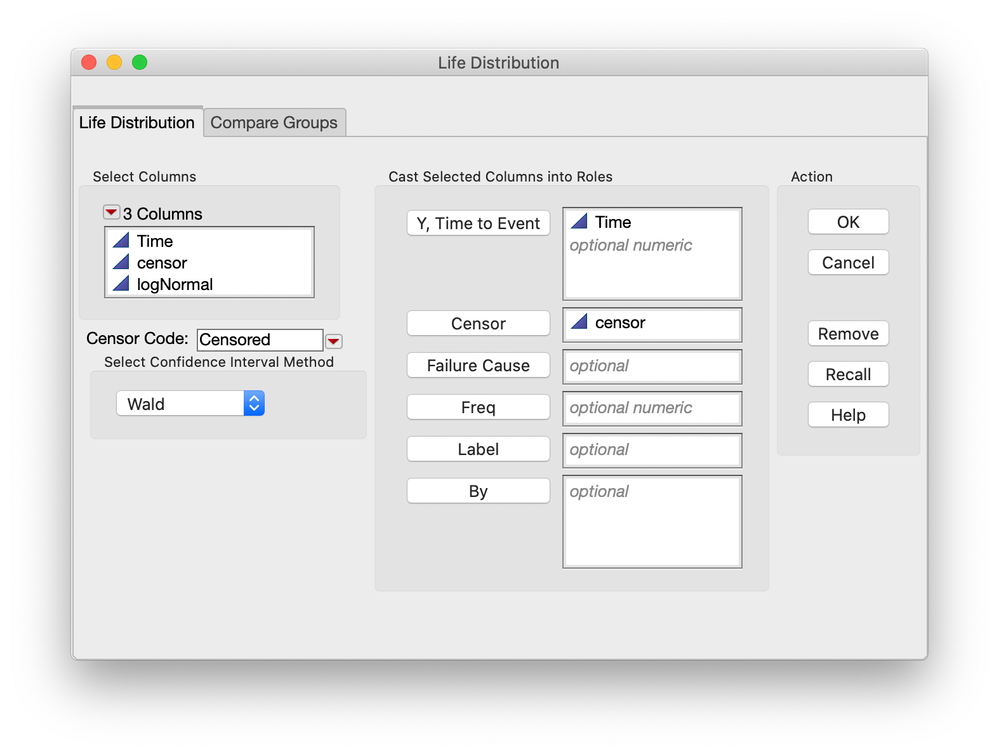

Select Analyze > Reliability and Survival > Life Distribution. Enter the time to event variable in the Y role and the censoring variable, if necessary:

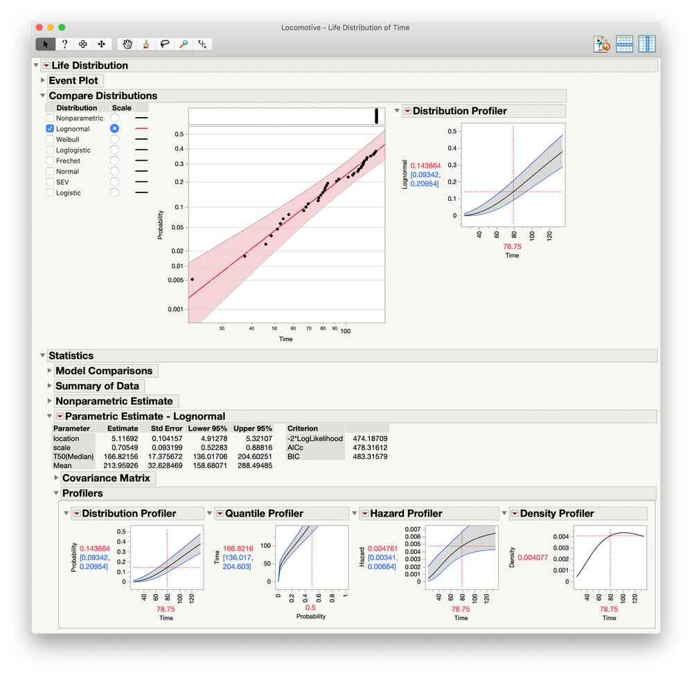

I chose a lognormal life distribution and scale for this data. Notice the set of four profiles along the bottom of the picture. The hazard function is profiled for you.
