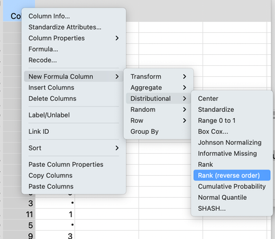

You can use a built-in transform for this. Right-click on data in the column of interest and select New Formula Column > Distributional > Rank (Reverse Order).
Clicking on the formula that is created, we have the following, which works whether or not the table is sorted:

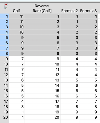

Below, we see the difference between the first formula and the next two. Again, only the 3rd formula is dependent on table sorting.
If you want to try this out, run the script below. It first appears unsorted, but after a one-second pause, it sorts by col1, at which point the results of the 3rd formula will match the results of the second.

For case 1, It seems my JMP doesn't have Rank under Distributional, it only have the first 6 options as you showed in the pictures.
I think the case 3 seems a better solution for my current issue, appreciate the help.
Re: Have difficulty to find 2nd max, 3rd max value in 1 column etc
You might be on an older version of JMP... does it work when you manually enter the formula I showed for that scenario? This may work for you--I can't recall when the by-variable support was added to the column functions... I think it may have been JMP 14 for a lot of them.
