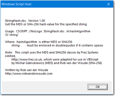

John_Madden,
I am not an expert and this might not meet your needs. Below is a VBscript for both SHA256 and MD5 encryption, Find it here at this link.
https://gist.github.com/jermity/557de47a978f7a7c4a74
I only know Windows.  Copy the attached file, and change the extension to .vbs. Open a Command window, cd to the save direcory and type jerhash.vbs to get the usage syntax.  The embedded script converts the statenames. This vbs script does not appear to allow a list of values. The 52 state names took 8.2 seconds, and I am sure the overhead for connecting run program adds to that. The attached script shows an alternate method of creating a .bat file. it took on the avg about 0.1 seconds for the 52 items. I did not read in the file. That is another approach. Generate the 500k offline then read in the file.
That's all I have.  Regards.
