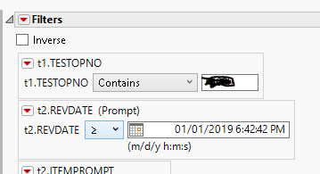

All my jmpqueries therefore has following filters , and I have kept the date as a prompt variable so that I can change it every time I run the query

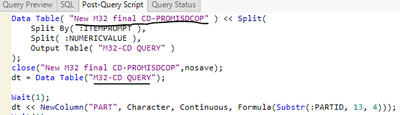

I also have some post processing script as almost always the data is not stored in the format and shape as I want it to plot charts. This forces me to create a new table from the table that comes out with the original query's extraction.
So, all my jmpqueries end up generating two tables an example is shown below;

  1. First, every query has the date prompt so I need to wait and give the date and click ok several times in between - how can I modify the queries such that the first date i give is taken and used for all subsequent jmp queries?
