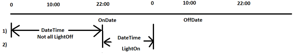

Re: Handling Date & Time stamps across midnight
The following explains what's wrong. Every row in your data table falls into one of the two situations.
1) DateTime is on the left side of the interval defined by OnDate and OffDate
2) DateTime is between OnDate and OffDate.
The second situation always gives expected answer. The first situation will fail nearly half of the time.
