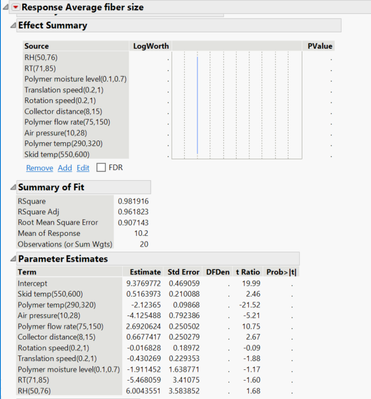

I am seeking for some suggestions/guidelines to fit a Custom Screening DoE for main effects. Below is the screen shot of the model fitting. My thought process is to remove those factors with t ratio less than 2 one by one until all factors left with t ratio above 2 and then use those factors to conduct a Response Surface Design for more detailed investigation. I will also use my practical knowledge when eliminating factors. Here are some questions that I have:
1. is it safe to eliminate the factors with their t ratios less than 2? According to JMP, it is basically equivalent to p value of 0.05 although there is no p value available for this design. Assuming no practical knowledge about the impact of the factors on the response.
2. Any other methods should be used?
Thank you!

Can you say something about the design? It seems like you have 10 factors. So 11 parameters (including the intercept) to estimate. And the Fit Model report says 20 observations (so presumably 20 runs). So I am struggling to understand why you are not getting p-values. Do you have random effects in this model as well?
More information would help the JMP Community to help you. Maybe you can attach an anonymised version of the data.
