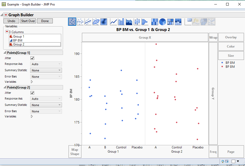

Hi, I am doing a repeated measures analysis and while making the graphs for one of the variables got stuck. So this graph has a group variable on the X axis(nominal) and the Y axis has 4 values of DNA (continuous) at 4 different time points. I got the graph neat and nice but the x axis shows values for both groups separately while I want them side by side. e.g. day 0 DNA both groups together, Day 4 DNA both groups together (side by side) but apparantly have tried everything but can't figure out how to do it.

I am making a guess, but I think you are trying to graph your results using Graph Builder.  If so, the only way that I know of to get the result you need is to add a second X column into your data table, which shows the second group of X values.  Graph Builder will only provide separate axes if there are separate columns.
In the example, drag the Y axis to the Y drop area, and then drag the 2 X axis variables one at a time to the X axis drop area, placing them side by side.  Below is the script that produces the above graph
