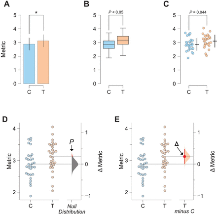

Hi everyone, I'm hoping you can help me produce certain graphs in JMP.
I'm using the Backgammon data set (Download the data set 2) from the case study library in JMP. I was able to do one-way anova and then t-tests. I then did a right click on the output and saved it as a new data table.
Can someone please help me produce similar graphs? Specifically the bar graph with the brackets.
PS I got this image from an online search.
I couldn't find any directions to follow from the online documentation, and would appreciate any help or guidance.
Thank you!

jthi
Re: Graphs in JMP
This blog post might be able to get you started Using JMP to create SuperPlots .
-Jarmo
statman
Re: Graphs in JMP
Those are called box plots.
https://www.jmp.com/support/help/en/17.2/?os=mac&source=application#page/jmp/box-plot.shtml
