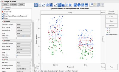

Once those steps have been completed, the plot will look like this:
We have all the components that we need, but we must now clean up the plot. On the left-hand side under the first Points menu, click on the gray triangle next to variables and uncheck Mean.
Under the second Points menu, click on the gray triangle next to variables and uncheck Speed.
Drag the Jitter Limit to the far left.
Under the Bar menu, click on the gray triangle next to variables and uncheck Speed and Replicate.
Change the Bar Style to Float.
Change the Error Interval to Standard Error.
Looking at the plot, now we can see that we are getting closer.

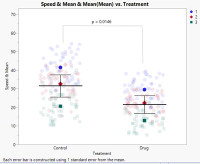

After following those steps, we get this final plot:
There is one additional component added to the plot in the article, which is a p-value. While JMP does have the option to calculate the p-value, it will have to be added manually to the plot. There is a line drawing tool and annotation tool that can be used to add the p-value.

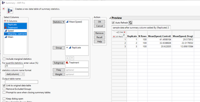

The p-value calculation as described in the paper is a matched pairs t-test, matched on Replicate. JMP can perform this test, although not easily with the data in the current format. To verify the p-value, we create a summary table. Click on Tables > Summary. Choose Speed, and then click the Statistical drop- down menu and pick Mean. Then add Replicate to Group and Treatment to Subgroup. Click OK.

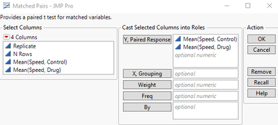

From the Summary Table, click Analyze > Specialized Modeling > Matched Pairs.
Drag Both Mean (Speed, Control) and Mean (Speed, Drug) to the Y, Paired Responses section.
Click OK.
From the output we can find the p-value.
After adding that to the plot, we get this final plot:
