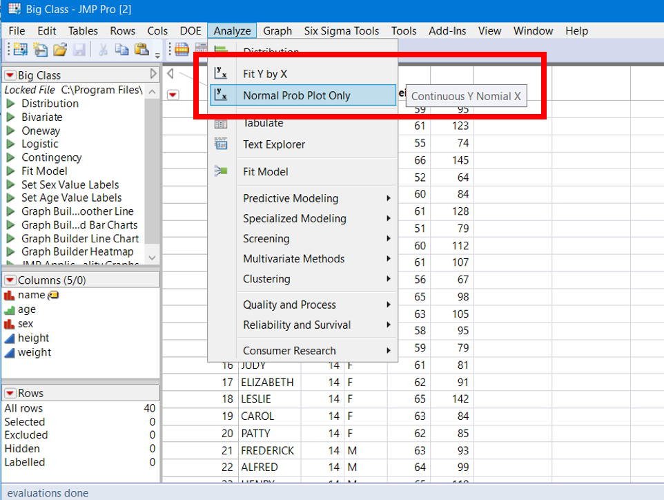

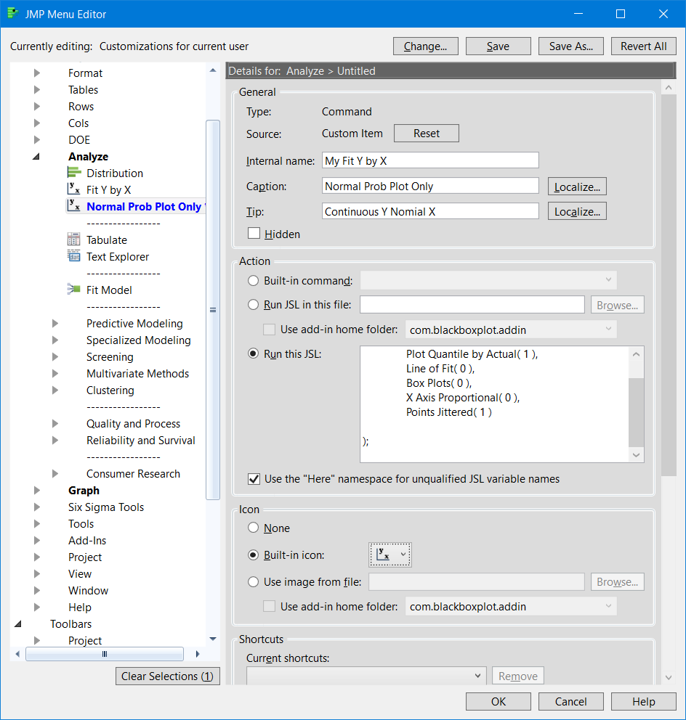

  5. From the menu select  View --> Customize --> Menus and Toolbars --> Main Menu --> Analyze  Left click on Fit Y by X and I'd select Insert After .  A dialog will appear, see the attached picture #1#. Notice the fields I selected..notice I mistyped Nominal. The entire script is not visible and I will attach below
  6. To run the custom analyses, open your data table, select Analyze. Select your script.  See attached pic #2. You will be prompted with the usual Fit Y by X dialog, user interface.
