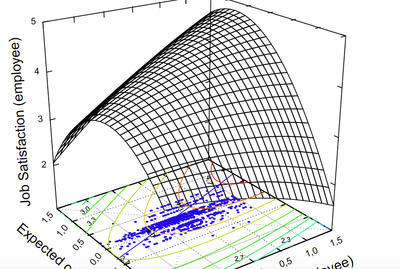

I am trying to do RSM with one DV and two IV, all continuous and I am wondering how to create a three dimensional graph as shown in attached. I saw that graph in a paper that uses similar designs, and hope that JMP has this function of creating this graph. Thank you!

I assume that you used JMP to design the experiment and store the design in a JMP data table. Furthermore, I assume that you fit the RSM model using Analyze > Fit Model or by running the Model table script.
At this point you want to use a profiler. Click the red triangle next to Fit Least Squares and select Factor Profiling > Surface Profiler. You can read about this profiler in Help > Books > Fitting Linear Models.

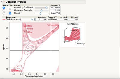

Hi, I just checked out the resources you pointed to, and came up with the attached graph from the Fit Model-RSM. It is starting to look like the one from the published paper, but not quite. Is there a way to fill in the color as in the paper? Am I missing something? Thank you!

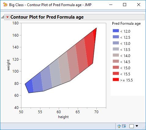

It is not possible to fill in the isometric areas with color in the Contour Profiler as far as I know.
You can produce colored regions in the Contour Plot if you save the model as a column prediction formula.
Select the Fill Areas command from the red triangle. You can change the color by selecting the Color Theme command in the same menu.
Re: Graph for Response Surface Methodology
I should add that the reason for the omission of the use of color as you see in the MINITAB example is not an oversight. JMP uses color in the Contour Profiler to indicate regions of disallowed response values. You can set the low or high limit and see what I mean. The color is determined by the response. If you have multiple responses, they can all be viewed simultaneously with their individual disallowed regions as transparent, overlaid shaded areas. The white are is the region where the response will satisfy all of the limits.
