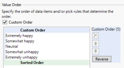

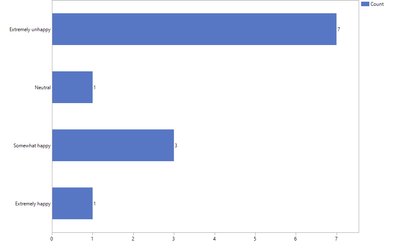

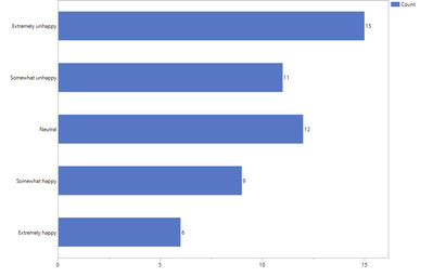

I have some categorical data (a Likert scale) with 5 levels, with some responses at each level. When I add a local data filter, one of the levels no longer has any responses, and then this level doesn't show up on the graph anymore, but I want it to (with a bar of size 0).
No filter:
With filter (notice "Somewhat unhappy" [second level from top] is now missing):
I have "Include Missing Categories" checked, but that doesn't change anything. I also set the Value Order for this variable (including all 5 levels), but that doesn't seem to change anything either:

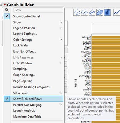

You might have to enable show excluded rows (hold shift and click on the red triangle of graph builder) if your local data filter is in Include mode

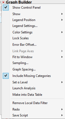

Hmm, odd behavior.
Maybe try checking this option from the red triangle menu?
JMP Systems Engineer, Health and Life Sciences (Pharma)
poetrymage
Level II
Re: Graph builder removes levels of a variable when adding a local data filter (and I don't want it to)
Yep, it's checked (I've tried it both checked and unchecked):

Oh man, another hidden option!  Why JMP has this secret options that only holding shift will reveal is beyond me!
poetrymage
Level II
Yes, that did it! Thank you so much!

There's a reason your rows are disappearing.  The local-data-filter is eliminating all rows that don't meet its criteria, so at that point the Graph Builder plot doesn't even know that category value exists.  Sometimes we'll put in fake data to make the category rows appear when we're doing these types of filtering actions.
Note, I know about the Show Excluded Rows option, but it's not always clear what it's doing.

Here is a collection of easter eggs which are hidden behind a  CTRL/Alt/Shift + click/select/double click/right click .
I updated the entry for Show Excluded Rows and added a link *) to this discussion.
