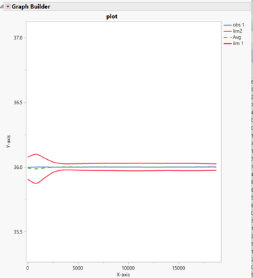

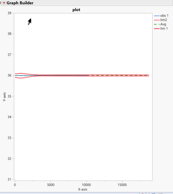

Hello,
I am making plots in graph builder that look at how observations look relative to limits. I have rescaled the y-axis and would like to add reference lines too. I do this and looks good. However when I add the column switcher to go through different observations the rescaled y-axis and ref lines disappear. Does anyone know how I would get them to stay while using column switcher to loop through observations? see images below of the rescaling happening with column switcher

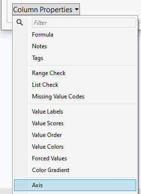

you could adjust the axis scales + add reference lines
... and save the settings as column properties to each of the columns:

Thanks! I tried this but unfortunately it doesn't work because my two limits columns are using Link ID to another data set. The reason being that my x-axis is time points and the current data set has many more time points than limits per time point
