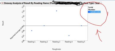

Hello,
For the life of me I cannot figure out how to make JMP unselect the legend? See picture to understand what I'm seeing. I went to change the color of the marker, and the legend will not unselect no matter what I click/right-click. It's very annoying I cannot figure out how to unselect the legend (make it not blue high-lighted). Does anyone know how to fix this?
How do you unselect the legend???How do you unselect the legend???
Re: Graph Legends - How to unselect the legend?
If clicking on it again does not deselect it, try Ctrl+clicking on it.
Dan Obermiller
Ctrl+Click worked! I knew it was a simple fix, I'm just not too privy to those keyboard tricks. Thanks!

statman
Welcome to the community. Yes, there are several simple click options that are very useful: right-click, ctrl-click (command-click on a Mac), and alt-click.  These can bring up many options in many outputs/platforms.
