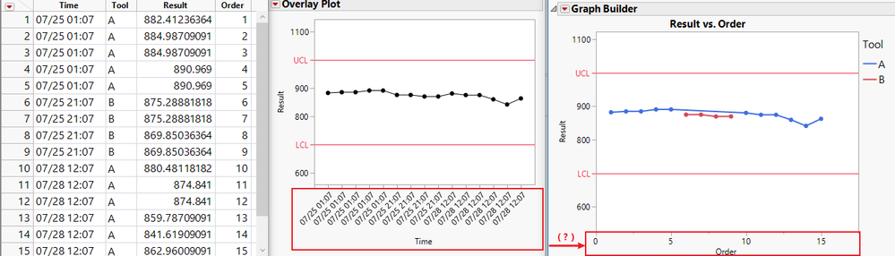

I would like to use graph builder to plot a SPC chart because the convenient overlay function for my data.
How to setup the x axis by row order but display another column value?
It is basically the same with overlay plot's not order x option, and the another column value normally is time.
There is the example:
I can use overlay plot get what I want but no overlay function to separate Tool
I can use Graph Builder get what I want but x-axis cannot show Time, if ues Time as x the plot will be totally different.

You drag the data column that you want to display to the X drop zone first. Then drag the Order data column just above the X axis and hover until you see the message to sort by the Order column. You should see the effect immediately so you know if it is working.
