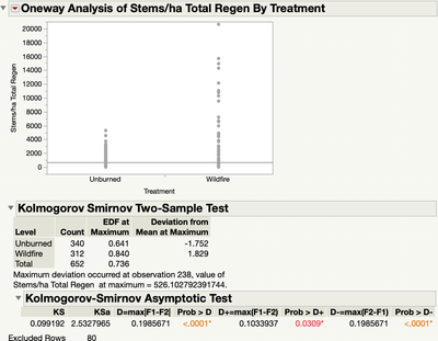

I am trying to compare regeneration density following wildfires versus unburned areas. I have non-normal data with unequal variances so I ran the K-S Test and got the attached output. I'm not sure which p-value to use. Thank you.

These statistics are documented. Select Tools > Help. Then click on your Kolmogorov-Smirnov Asymptotic Test report. You should go directly to the help for the platform. You will find another link under the name of this test that explains each of the K-S statistics and how to interpret them.
