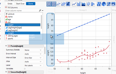

Re: [Graph Builder on JMP16] create multi-axes by drag columns into dropzone with shift pressed, the order reversed, how to fix
can you share a screenshot what does the "reversed" mean?
Without Shift all the columns end up in one plot. Which "order" do you refer to?
For this example here it's also "height" and "weight", like in the previous graph:
(not weight and height)

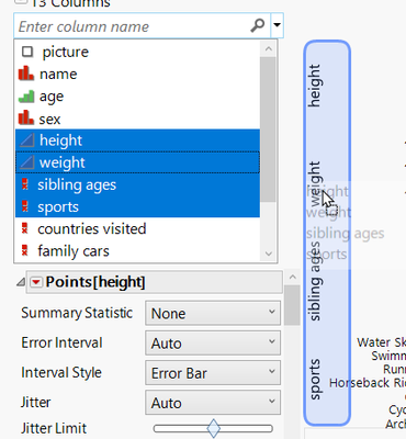

I will describe based on your figure, like I have height weight sibling ages sports to the ax, the order <in one plot> on the graph is height weight sibling ages sports top down ; but it will be sports sibling ages weight height top down by each plot by pressing shift
In JMP 18.2.2, pressing Shift, it looks like this:
yes, exactly the same operation on JMP16, the "sports" shows on the top, and unfortunately I cannot update my JMP16 to JMP18, is version diff the root cause?
